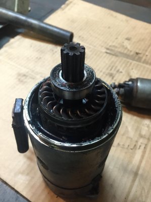

Starter been working but dragging , Spin's the 7.3 Slow . There is a local starter repair shop in town, He charges $60 labor plus parts to completely rebuild it . Or i can do it my self.

I was able to locate a Mitsubishi Starter rebuild kit
Spun4Fun
Feb 1, 2015
512
12
NC
I took the starter apart and it was soaked with oil ...
ONE THING I LEARNED after i screwed it up is the silver soldiering must be done with high temp big massive iron or by spot wield to wield / solider the new brushes to the field coil . What that being said it coasted me a new field housing with new style removal coil . I have $164 ( $120 lesson include new field housing and starter guy labor + $45 rebuild kit ) total into my OEM Mitsubishi starter that lasted 24 years and hope to get plenty years outa of it .
I just did not want to buy after market Chinese sheep Shitz starter for almost what i put into mine . Would i do it any different pro yes ( take it to the starter guy directly) could saved me $60
armature cleaned real well and shined like a diamond
All and all i happy with the result , The truck start as soon as the key turn . Here is a few pictures of the Kit part # and the inside

Solenoid checked OK .My issue was slow cranking due to worn out brushes as you can see along with crud /oil soaked .

I sure hope the arameture copper brush area was not reinstalled looking like that. New brushes will not last long with that eating them up. Also those gaps in the comutater needs to be cleaned out too. Usually this kind of work is done on a lathe.
Yes that was cleaned real well , I dropped the Starter at the starter guy and he gone thru it part of the $60 i was trying to save ;Really
