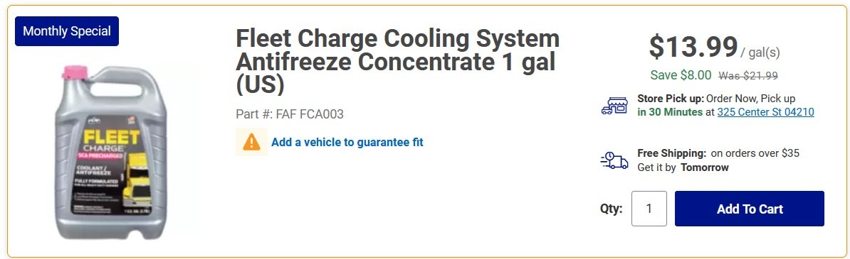

I just grabbed 4 gallons of this. My green stuff looks fine but this was cheap enough that I may switch over.
Sale price ends at end of the month.
