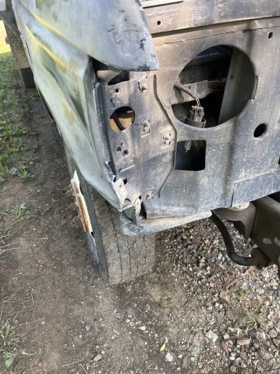

Dent on passenger side fender is worse than I thought. It crushed the core support a little bit, but I think that you could probably almost pull it out.
