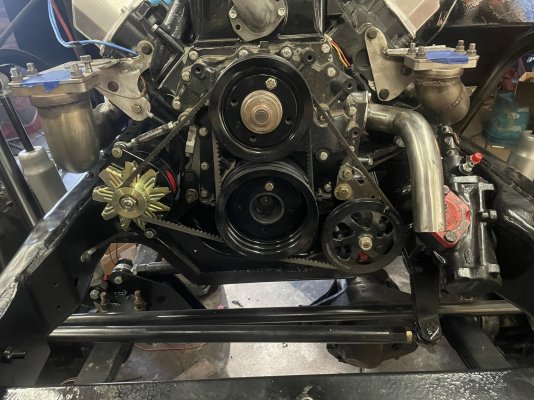

i wouldnt do a 3g.
not with V belts.
i would 1 wire swap
ive been running a 160A 1 wire for several years
1,875
1,929
I too run a one wire 130amp Power Master Alternator.
Installed a SW Volt meter in the center of the dash,
I have no tach.
1,875
1,929
One wire Alternator has the regulator built in side it.
I rant 2 6ga wires, one to the battery (+)
and the negative connects to a bolt on the back side
of the Alternator, and runs to the battery Neg (-).
Then deep 6 the fender mounted Ford regulator.
