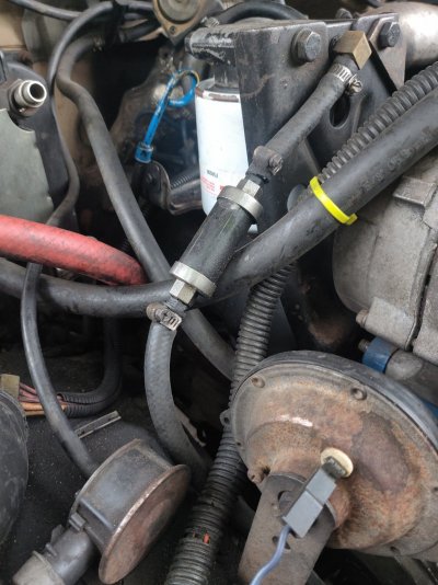

I actually did that, but until I get my returns going somewhere other than the diesel tank I just muddy up the diesel so there's no telling.
Thanks for the pic.
And yes, the return line looks like in your pic for quiet some time - until it got cleaned by the diesel.
Nachschlag:
I want to confirm, that a 2-tank system is recommended if you want to drive straight WVO.
But - like said - it will only work on longer distances or longer engine running time - in case you still have the mechanical LiftPump running.
Our fuel lines a quiet long - and our filter(s) are also huge.
My return line goes to a magnet valve.
The valve switches
-back to the WVO tank
or
- in a loop back to the LP
The main Diesel tank is not connected to the return line.
This setup ensures, that the middle tank contains always clean/straight diesel.
If you use an electric transfer pump, then you may add an additional "flush-button" in the cockpit. This you'll press if you want to drive the WVO/WMO till switching off the engine or if you forgot to flush before switching off the engine.
Then the content of the filter(s), fuel lines and IP is pushed into the WVO/WMO-tank.
