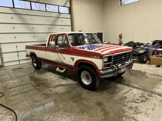

I did halfway hack paint job on my 89 black truck. Sanded it, primed, base coat, clear. Body work isn’t fun to me but it’s easy. The quality depends on your patience and time you want to invest. You can imagine I didn’t invest a whole lotta time. My favorite things are mechanical and actually electrical, no joke.
I also cut the bottom quarter of the cab off and rewelded in new.
Every time I do this I say to myself I’m never going to do it again and then I do it again once I see the cost of paying someone else.
Also on this truck I didn’t even bother cutting and buffing the clear. On other cars I’ve done, I did, and came out like factory finish. This one’s got the German orange peel finish.
