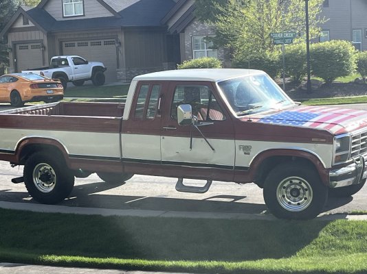

No clue where these came from or what they are the just came in the truck, I think they look good but this truck is no where near high enough for them to be useful
Not quite the location you described but oh well

I was picturing on the interior but thanks. Those certainly would be an easier install.
Although, they don't look very useful. May be helpful for the guy that has to ride in the back seat. ;-)
