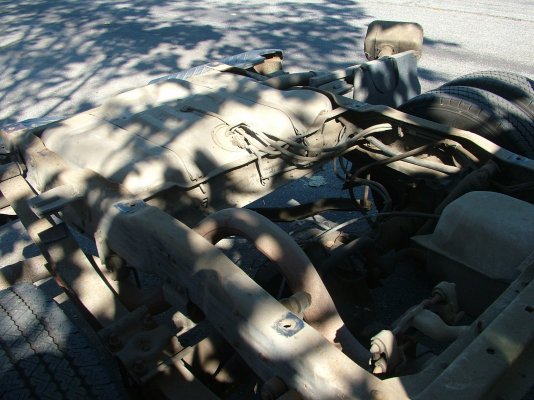

The best picture I could get, sorry. Truck is parked in a puddle right now. You can kinda see the pieces of angle welded to the frame.
This bracket above the overload bracket is for the 5th wheel rails.
I appreciate the pictures Chris, and I like that setup. Now you got me thinking:bail.
