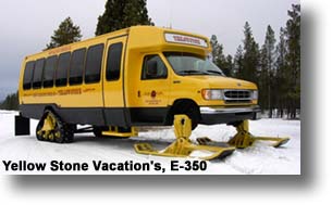

Looks like it has been done before, found this picture.
This isnt the same setup as your first pic. THis is a us gear/doug nash overdrive unit.
That first pic, I have never seen a gear vendor like that. But I have never seen one with a tailhousing brake.
If it would in fact bolt up between the trans and t case, you would be able to use Od while in 4x4, but my concern would be adding the extra stress of a t case clear at the back. Based on my own experience and what I have seen with GV, putting it in front of the transfer case will remove the option of driving on the front driveshaft when it fails. Being able to use low range would help it out with the reverse type failure though....
