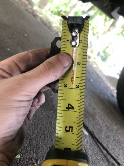

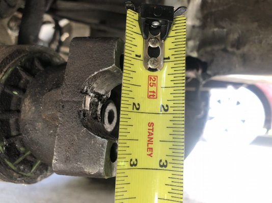

I recently purchased a truck that has no driveshaft. The previous owner did an axle swap but put a gasser 3.55 instead of a Diesel.
The one without the driveshaft attached is the smaller one, & the one with the strap is for the Diesel.
I’m trying to figure out what I’d need to do, & I’m scared I’d need to swap axles for one that has a bigger yoke.

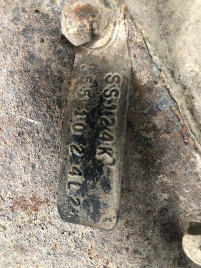

Attached is the axle tag:
SS124K
3.55 10.25 4L21

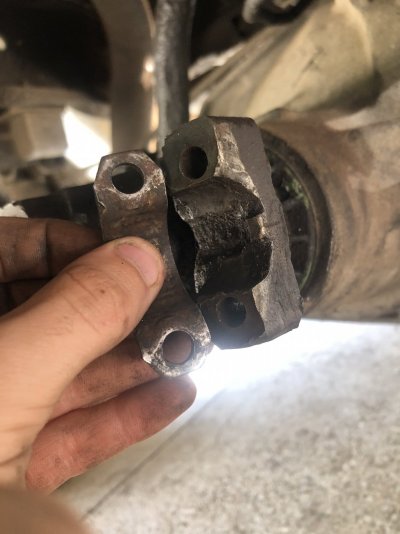

The truck needs a driveshaft, & the wrong size caps-hole width is different.

Oh the u joint straps are incorrect! Gotcha. You should be able to find straps based on what u joints are used.
As for sourcing a driveline.... Wrecking yard? Or have one built, but that's gonna be spendy.

I don't have the bandwidth to load the pics right now, but you're likely dealing with the difference between any of the 1330, 1330C, and 1350 yokes. There are conversion joints for those.
If you want the max strength and both are long-yoke diffs, I suggest getting a solid pinion spacer, a new seal, and swapping the yokes over.

Yes, if the rearends are the same, just swap the yokes. That is what I had to do when I swapped in my zf 5 speed. Same year truck and all, but the zf had bigger u-joints and a thicker driveshaft.
This will start the "oh no, you have to get a new crush sleeve and set the pinion bearing load" debate, but I have never done that and never had a problem. You do need a large impact, that pinion nut can be hard to get loose with just a breaker bar. Once you install the other pinion, you can tighten it as much as you can with a breaker bar and a piece of cheater pipe, or you can let the impact gun hit it about 3 times after the nut stops turning and you will be good. The old sleeve has already been properly crushed to the bearings that are already installed. You just need to tighten the nut up so it won't come loose. You can put a little blue loctite on it for insurance.

The yokes swap so long as both are long or short pinion. The split is around 92. If the yoke has play on the spline (usually leaks too) you should get a new one.
Re-tightening a yoke on a used crush sleeve is easy to get mixed results. If overtightened, pinion bearings fail quickly. The solid spacer w/shims makes it darn near foolproof because it can take full nut torque without reloading the used bearings.
