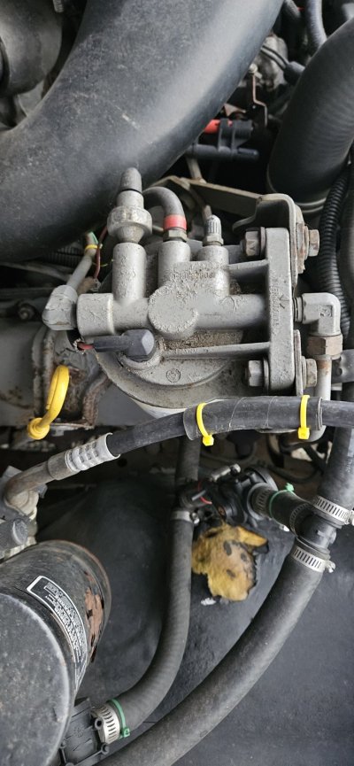

In that thread, the second post shows the voltages that fixed his shifting.....
Maybe raise your idle voltage to 1.35V......and let the high side be what it is. I’m just throwing ideas. Good luck!
