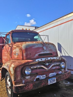

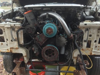

Hey guys, I have a 55 Ford C600 and an 88 DT360 mated to a Spicer ES42-5D. I am putting them both in the C600. I pulled the DT360 and have it in the garage getting it sorted and cleaned up. I have a bunch of questions for you!
On the engine-
Is there a power steering pump block off plate available or do I just have to make one?
Does anyone have the basic wiring diagram for the engine? There are all sorts of wires I need to remove, I want to be as clean and simple as possible.
I need the turbo to intake pipe that goes over the engine if anyone has a spare. if not I'll just piece one together.
For the trans, I need the shifter to be about 14" forward of where it is. Can anyone point me towards how people are relocating the shifter?
Thanks much!
