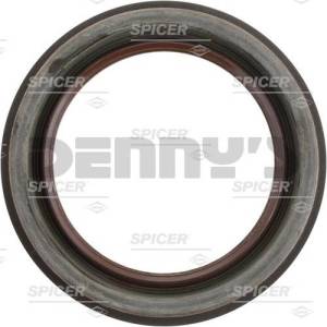

With the doc I found the seal on page 176 position 34 in the drawing.
Using the BOM 605639-1 and going on page 187, I get the part number "46004".
When I now search for this number then I end up here:
To me a drive-shaft is something else than a inner shaft seal.
What now?
