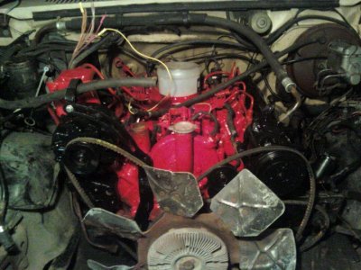

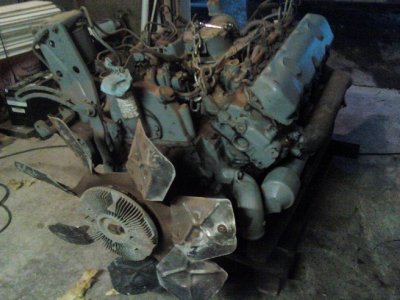

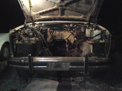

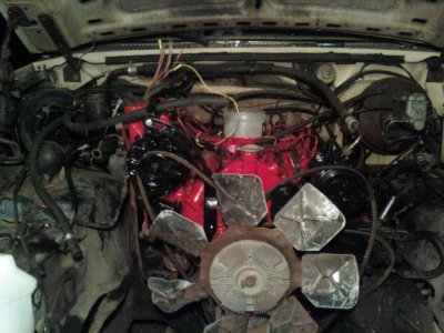

ok heres the pics i took while i was building this toy. its currently put up at my farm. i love this truck and wont drive it on illinois roads during winter time. i bought it off my grandpa it only has 110000 on the chassis and body but still has some rust but im not asking for lots more. you could probaly get by with a stock radiatior but i dont like to get by with anything, i love over kill!!! Ford trucks the best never rest!!! except mine wen it gets icy, lol

thanks a bunch for the pictures. I am defenitly going to put an idi motor in my truck now. if i knew i was going to be doin this a while ago i wouldove gotten some parts off a 1987 ford f350 6.9 in a junk yard close to my school. so parts im going to need to collect so far. diesel core support, diesel radiator, coil springs, motor, tranny, glow plug wireing, motor mounts and mount plates (the ones that go on the frame, didnt know the technecal name :dunno) o i cant forget the battery tray and second bettery, and another cable to run one battery to the other. if i have anything wrong or missing please chime in and add to my list.:thumbsup:

you pretty much have the basics anything left will come to you. I hope I helped, mine has 3.50 gears and after it gets to about 40 you cnt get to 70 in no time but no overdrive you won't go much more than 95 or 100 before you tach out, not that you really need to in a full size truck.
