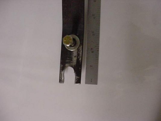

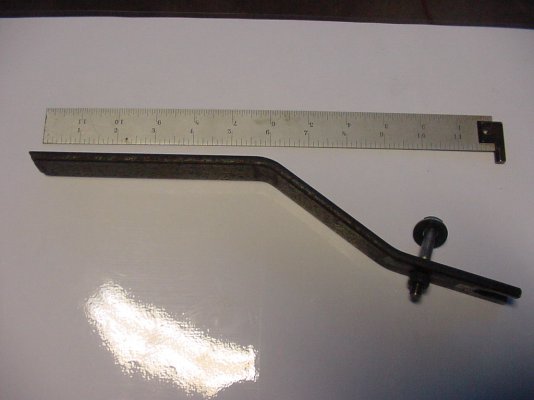

The valve stem seals can be replaced insitu. You have to make a simple lever to push the valve springs down and you have to create an adapter using part of a compression tester to pressurize the cylinder while you work but it can be done in an afternoon or so. Much better than pulling the heads. You should know that valve guides can get quite worn on high mileage engines but if yours was reasonably taken care of and being a turbo motor, @ 190k I’d consider it maybe a little over half life, not really ready for a head rebuild yet but definitely a candidate for valve stem seals if other leak remedies don't make enough difference. Make sure you rotate each piston to TDC for the cylinder you are working on so if a valve drops by accident it doesn't go all the way into the cylinder. You can get close enough to TDC by putting your finger over the glowplug hole on the compression stroke and feel when air stops bleeding out and starts to suck back in. You need to regulate the air pressure to only use just enough air pressure to hold the valve up but not turn the motor over, otherwise it will spin to BDC and then the valve can drop into the cylinder. It helps to get as close to TDC as possible and leave all the other GPs installed to create resistance to turning while working on a specific cylinder.

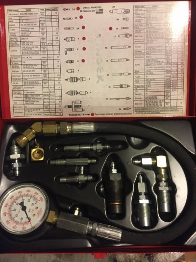

Here's a pic of a tool I made to compress the springs. It pivots on a rocker arm bolt. Also attached is the compression tester I used to create the adapter to pressurize the cylinder I was working on.
