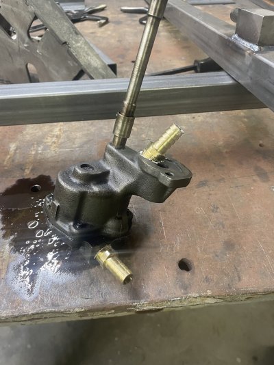

Ended up throwing this together for now. Haven’t tried it yet
