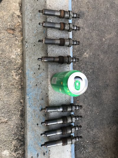

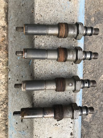

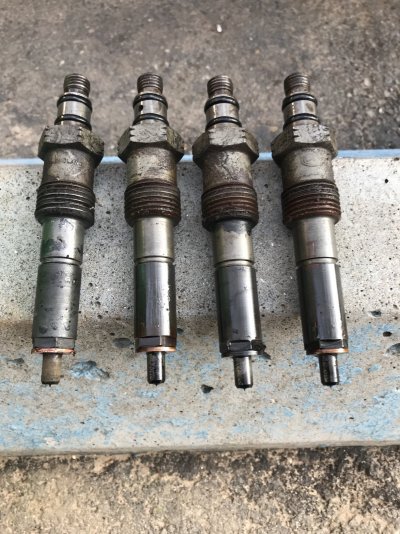

I took pictures of the old 7.3 idi injectors. I’m hoping to get some information based on the appearance of these injectors. All input is appreciated. Thank you.

Looks pretty normal to me for old injectors. I'd be more curious about pop off pressure and spray pattern rather than physical injector looks.

I was a little worried about the wet/crusty/rusty colored looking one from the back drivers side cylinder? I installed new ones. My return lines got to leaking so I did the unknown age injectors as well.
I'm guessing that this is the one in the close up. It looks like it might have unscrewed a little bit to me. There looks like there fuel between the two parts of the injector body. Other than that, nothing looks completely awful to me. I don't know what causes the rust, but I've seen it before.
