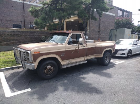

2wd front ibeam axel swap question. NOT 4WD*
Cainon
Sep 27, 2019
221
47
Smithfield
I see a lot of 4x4 swaps. I want to keep mine 2wd. What front axel do I need or get away with. If I take it off I can put it back. I'm on my cell phone searching and welp, hopefully someone can just answer this. I want to get rid of this ****** I beam hell. I also want to stay 2wd. Is this simple or is there a lot involved? I've removed the rear and reassembled. Done all the work on this myself except bottom end and injection pump. Pump was pro rebuilt and I removed and re installed myself. Did all the bushings and **** on the I beam now. Alignment myself and holds up. motor... Well needs love and nobody around me wants to help or knows what they are doing lol.
Just looking for what 2wd axel swap I need and do I need anything special equipment wise. Thank you for your time
