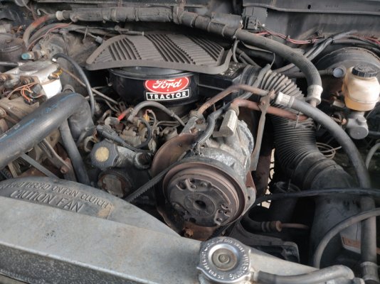

The regulator makes sense. As far as a cowl seal, I put a rubber floor mat over my air filter housing and have it draped over the back. It's cheap and you probably have one available.

Not bad looking.
When cold the oil pressure can be high, like 40psi and such. When at OP temp, mine and my dad's truck sit about 15-17psi at idle.
As for cleaning the block, I wouldn't bother. Coolant or water will mostly evaporate during normal running.
I like your ford tractor sticker on the air cleaner - that isn’t a factory replica sticker is it Jesus?

Not bad looking.
Good reference point, thank you. Maybe instead of buying an Amazon kit, That $30 is better we’ll spent buying a dedicated gauge. Like this one
