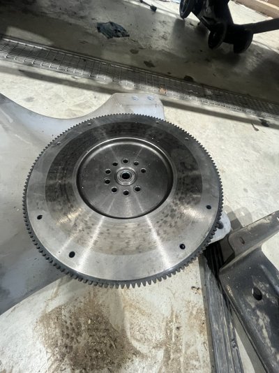

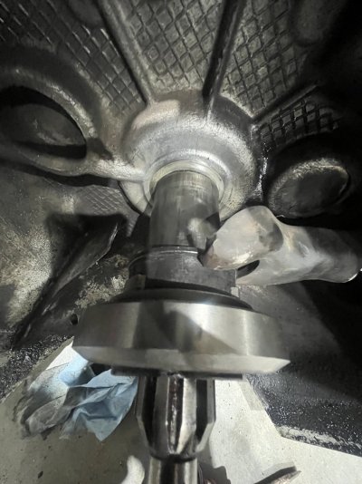

Transmission perfectly fine just took it out everything looks flawless no input shaft play all the gears look brand new
But the brand new flywheel looks like this heat marks from presumable slipping pressure plate looks the same is this going to be an issue running this?

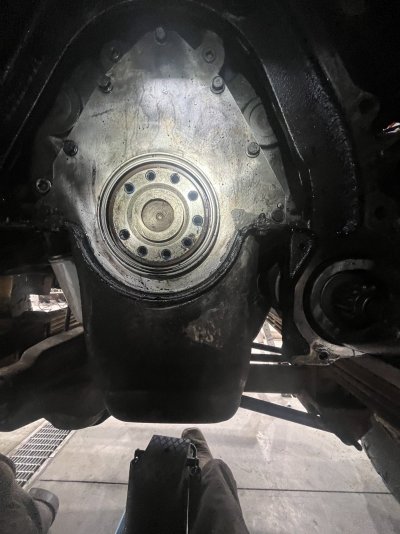

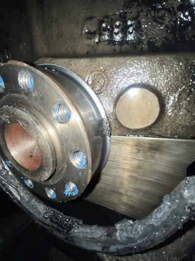

Do y’all see anything wrong with the way I installed the rear main either?

Looks like there's a small drop at the bottom of the rear main seal. Is that just residual?
That flywheel will need turned or replaced, that's pretty significant wear.

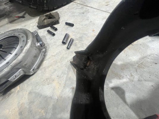

How's the release fork on the trans look? I've seen the tangs be bent, and cause it to not release fully. I've also seen the throw out bearing not seated in the fork correctly, and it kept the clutch partially disengaged the whole time.

Why is there a long shadow on the bottom part of the rear main seal? Is it in all the way? Those large seals like that can be difficult to install, the factory uses a special tool to install them. They are so big they are weak, its easy for them to be wavy if they are not driven in evenly all the way around. Any waviness will cause them to leak.
Did they give you a driver with the seal? If not, maybe you can get a new one and check a local machine shop and see if they have one to drive it in straight.

Theres rubber in the crank sleeve?

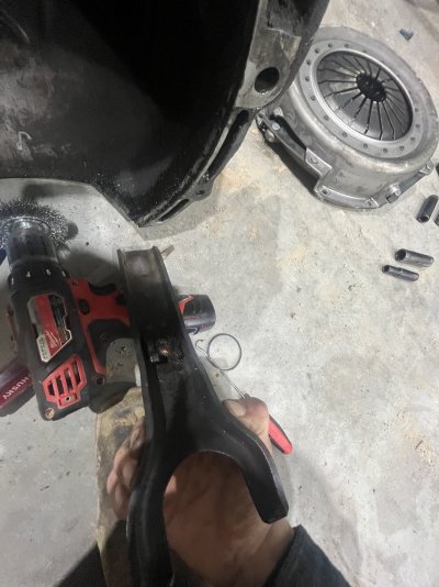

When I put the clutch on the input shaft I can tilt it like 10 degrees is that normal?
The tangs on the fork apeared not to be bent

Does that fork look ok to y’all I’ll it’s a bad picture I can only take .5x

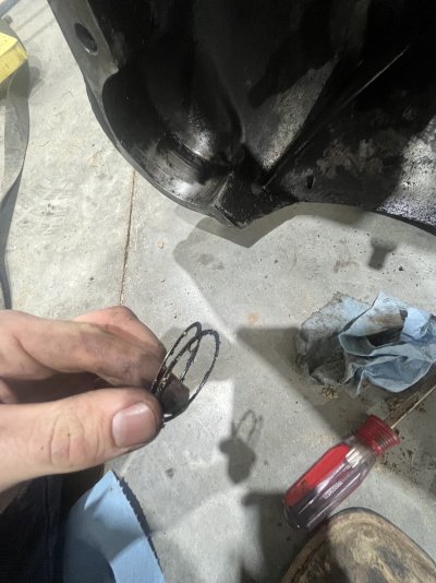

I found some shims on the input shaft are these supposed to be here? If not maybe that’s why the clutch was getting wierd?

is this an issue or is this normal
It’s precision clutch from rock auto a part of the “solid flywheel conversion kit”
Are you sure that it's rubber and not RTV? I haven't seen that style of sleeve before so it all looks strange to me. That's just an observation so don't think it means anything.
From what little I can see, it looks ok to me. I've heard of forks that have cracks in them so check it all over closely for cracks.
I also haven't seen those before and I have no idea what they would supposedly be doing.
Again, it's hard to tell from the video, but a clutch isn't a tight tolerance fit. A little bit of movement like that is probably normal. As long as the very center piece of the clutch that has the splines isn't loose from the rest (I couldn't tell), then it's probably fine too.
no I’m not 100% on if it’s rtv or
Not but it’s the same exact color as the seal and the rtv I used was black and so was the rtv used prior
