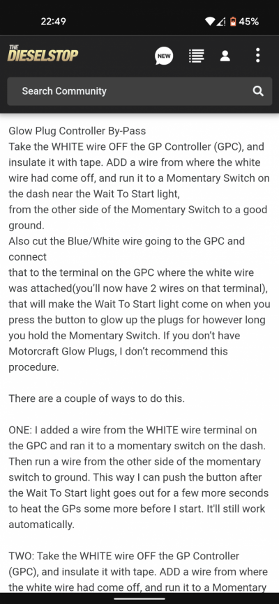

Your 93 should have the controller on the back of the engine. Climb up in the engine compartment after you take a few things off to see it, and find the white wire bolted to the controller. Take the white wire off and tape it good so it doesn't short out. Then get a new piece of wire, put a end on it and bolt it were the white wire once lived. Run this new piece of wire through the firewall and to your momentary switch. On the other side of your switch run another wire from there to a good ground under the dash onto a metal bracket or something. That's all you have to do. When you ground that terminal where the white wire was, it activates the glow plug solenoid and glows the plugs as long as you hold the button.

I agree about the resistance in the circuit which isn't getting solved being an issue. That's reasonable. Also, about being stranded if the controller or switch fails. If you have a controller, you can take a jumper cable and bite the solenoid and hold it there for about 10s in a pinch. It'll spark when it's out on and take off, that's normal. If the switch fails, just pull the wire off and ground it for a cpl seconds to the steering column and your good to go. Just make sure to insulate it so it doesn't turn on.
