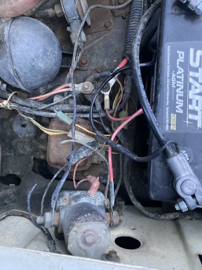

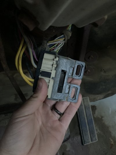

The battery is still at 12.5V. And here’s the fun part: he was working with the steering column so to start it I’m using the rod on the ignition switch. I can cycle the glow plugs still, I can hear that going, but when mashed in it won’t crank anymore, not even a little. Thoughts?
Here’s some photos. The terminals I tried to short with a screwdriver was not the one on the firewall.

I've been starting my truck with the ignition switch for almost a year lol. Called procrastination.... Just push the switch all the way forward and it should crank. If not cranking try changing the switch out. No change return it and keep the old one. Make sure battery cables are on secure, try tapping the starter solenoid and starter with a hammer to see if it'll start.
Never-Have-I-Ether
I’m going to have to give it a couple whacks tomorrow after work and see if that won’t wake it up. The thing is it was cranking when i mashed the switch forward but then I put a screwdriver across those two terminals on the lower relay and it wouldn’t crank anymore after that… I was thinking maybe I did it wrong? If my dad heard you say you’ve been doing it from the switch for a while it would make him feel a lot better! LOL

If what you jumped was not on the fender then it was the wrong relay. The relay you're looking to jump is on the passenger fender, jump small insulated terminal to the hot. You can also test if your ignition switch is working by putting a test light or volt meter on that plug at the small terminal and actuate the switch to "start". It'll read 12v if the circuit is working.
Using the relay on the fender also takes the rest of the circuit out of the picture and is a good place to start for troubleshooting.

1) Your starter relay (Upper one on fender) has side posts so no way to use a screw driver post to post. Guessing you used a screw driver from the little post to the big post that is hooked to the battery. Likely from the pic the solenoid terminals are corroded and have voltage drop or the solenoid has seen better days.
2) Run a jumper cable from 12v+ on the battery to the solenoid post with the wire going down to the starter. Truck starts replace the solenoid. Truck does not start replace it anyhow as it’s all corroded and looks very old.
3) Does not start with a new solenoid, clean the block ground and 12v+ connection to the starter. Starts, send it.
4) Does not start put in a new Powermaster starter.

Hijack away! Gives me some good reading material haha I got the truck in the shop after work. Stupid me was trying to jump the wrong relay posts. I probably fried some fuses along the way :shoot:
I went ahead and put two new batteries in the truck and a new terminal connector. Truck fired up super fast, hardly any smoke and sounds good. Now I got it in there I can start fiddlin around with it. Thanks again ya filthy animals!
