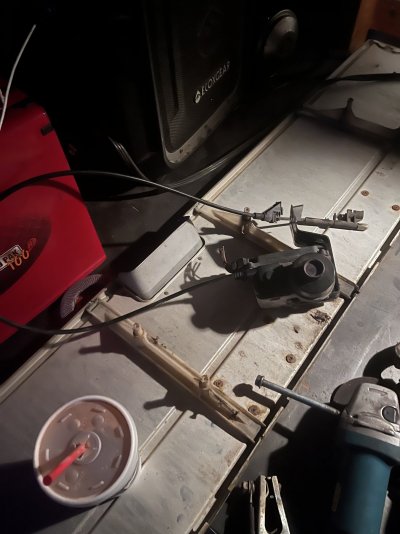

Wasn’t sure what I was really getting but I got this, and the brake switch connector my hydro master already has the switch
