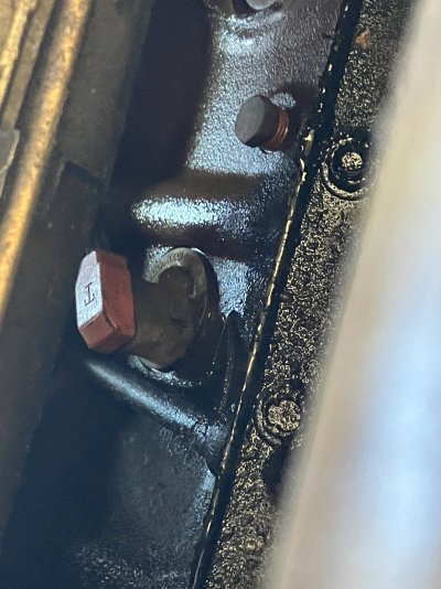

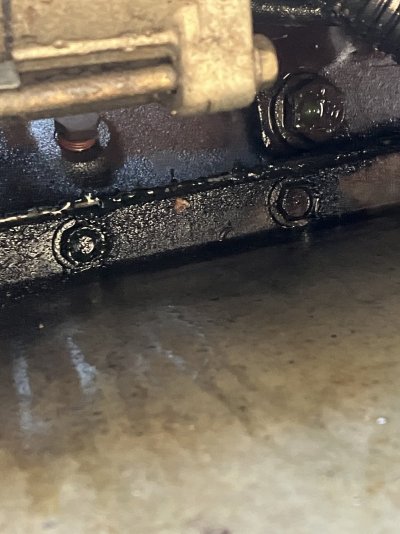

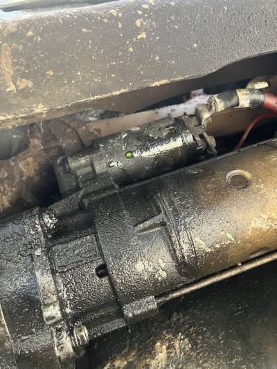

Update with a few pictures from today: any better leads from this or any idea how I can try and track it down better?

It only does it when I’m not driving and the day begins to get warm and the sunlight warms the truck up.

If I was doing the looking the first thing I would do is hose off the engine. Let it dry and then pressure test without running so the fan would not be blowing anything around.
If nothing shows up given a reasonable length of time then I would plug in the block heater so you get a temp change within the cooling system.
Starting with the engine dry you should be able to detect where the leak is coming from.
12,398
11,141
How do I track a coolant leak from top down?
They also make a dye that you can put in your cooling system to help find leaks. You will have to run the engine and then shine a UV light all over to see where the leak is at. There's more to it than what I said, but it's the short version.
