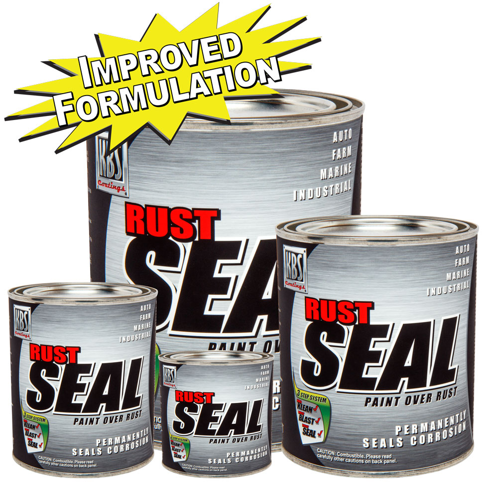

I recently had the bed off and replaced the rear fuel tank. While doing this I replaced the rear spring brackets and cleaned up the rusty frame and cross members. I used this KBS product and I think it work pretty good. More time intensive but good results.
