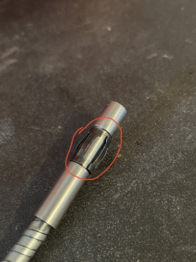

I just bought a DTI Tech Time 3300-s timing meter off eBay a couple weeks ago. I’ve read plenty of threads on this site and others saying that the probe has to be filed to fit or the bracket hole has to be opened up slightly. I went ahead and filed the probe slightly and it fits good in the hole now. However, I can only insert it without the radial spring. If I put the spring on, it WILL NOT go in the hole past the spring. I have tried everything I know of. Anybody have any other ideas? I have used a 5/16” bit by hand and even double checked with a mirror - the hole is clean.

I just looked at my unit, also a 3300-s, and am uncertain about your "radial spring". I have nothing which meets that description, and nothing which attaches to the inserted probe. Could you please post a picture of this spring?
BTW, my 3300-s works quite well with nothing attached to the probe insert.

I may have used the wrong terminology, it’s this piece that puts tension in the port to keep the probe from sliding around inadvertently.

Yep I use it with no radial spring probe ground down a bit and harmonic balancer port drilled out slightly

How do you keep the probe from sliding further down the port as the engine is running? Mine is snug but not that snug I don’t think

I see the difference now. My probe has the detent to hold the radial spring, but my unit was not supplied with such a spring. I did not file down the size of the probe, though I did ream the hole it fits in, hand twisting a drill bit, size long forgotten. Mine is a snug fit, to the point I don't worry about the probe moving while the engine runs.

I messed with both "drilling" out the bracket (that didn't seem to accomplish much) and sanding down the probe. I sanded above and below the springs and finally got a good fit and have used it successfully about 15? times since then and I think? I've got my timing in a good spot. And I can get the probe in and out without too much trouble.
Even then it's still finicky about how far to seat it. Some say 2 +/- index cards? I messed with that and found if I just jam it down all the way it ended up working better than trying to find the right spacing. YMMV. Or you can buy the timing light.
