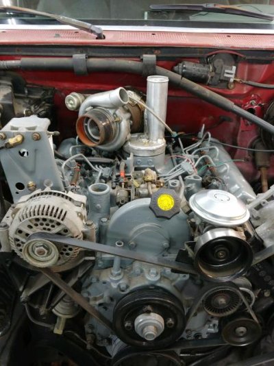

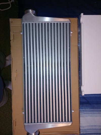

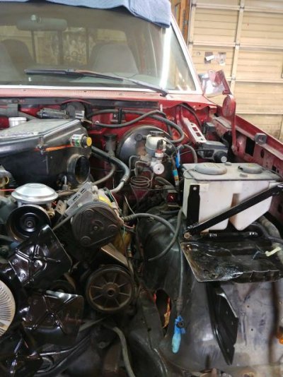

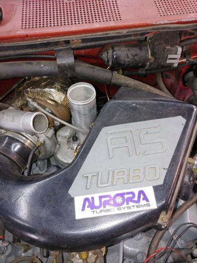

Finally got around to doing my truck project,got laid off so perfect time.pulled out a 460 A/T.
1986 6.9 studded going in, low mile pump turned all the way up.ATS Aurora 2000 turbo kit, 3 inch D/P
3.5 exhaust 8 inch long sprint car muffler,no packing in it.Zf 5speed with gasser gears in it,better ratio.
stock injectors popped at 1900 psi.nozzles were great, took apart other injectors for shims.
will be intercooled also. 1997 cc short box
