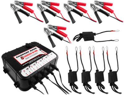

I use this to keep my truck batteries (and all my lawnmower/motorcycle) up to speed when they wont be used for awhile. Maybe it's trickle charge would bring your batteries to life?
