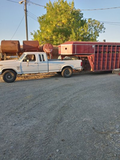

Stock suspension on 33s yes on drive shaft carrier bearing, brand new when I had the driveshaft rebuilt. U joint was new and lubed up but not over lubed, tranny mount is square, truck travels straight down the road. Leaf spring are newly replaced . To the best I and several mechanically inclined buddies and the driveline shop can tell all components are aligned. How much is too much pinion angle? Naked eye hey that don't look right? Or half a degree off and your burning out u joints?

Not the best pic for under the bed but only one I have on my phone right now. When it blew we where pushing up a big hill with one horse in a bumper pull trailer on the free way.
