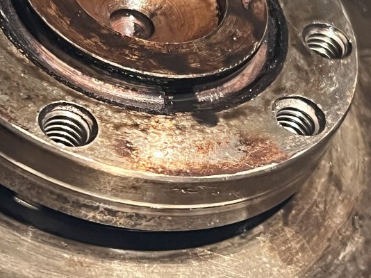

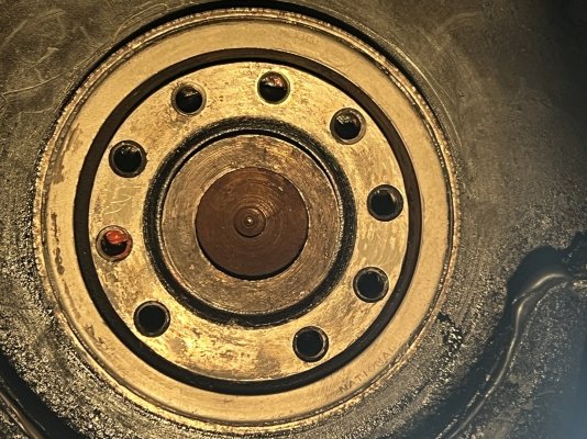

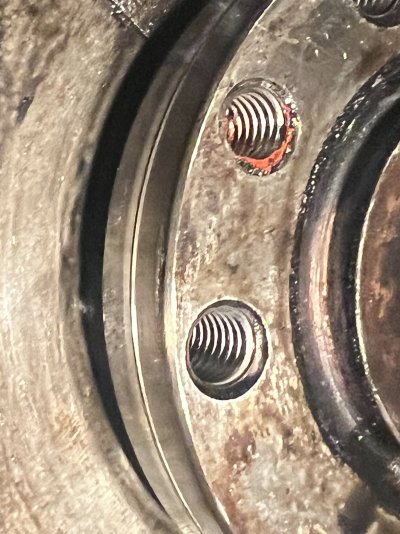

I just finished taking the clutch and DMF out. It was definitely shot. Springs were still tight, but it had about an inch of play. Getting that engine cover off is a bit sketchy whoever sealed it last sealed it very well. There is a tiny groove it’s not that bad. You can see it, but cannot feel it even with your fingernail. It it pretty obvious if a sleeve was installed I’ve looked at a bunch of pictures, but I cannot tell if this is a sleeve or just the bare crank?

So, if you cannot feel it with your fingernail drug across it, it is probably the shiny spot where the seal was riding. If that's the case clean it up with maybe a touch with a scotchbrite pad only going with the "grain" (direction of rotation). You can check if that is a sleeve on there by measuring with some calipers the hub diameter. I believe there were two diameters of crank hubs, only because on rock-auto a 3.750 and 3.875 diameter seal is listed. Those are the nominal factory hub base diameters I'm thinking. If either is say, .020 to .040 more than the base number, there is likely a sleeve on it.
If you click on Wrenchwhores post #5 above and click on the post he references then back up a page, you will see what I had to deal with a couple of months when I originally posted it. If its smooth like you say, just use it.

I don’t think the seal was leaking so I’d like to get this right and keep it that way.

I hope so. I’ve never replaced this type of rear main seal before, but it does look like it is naked. I’ll order a sleeve today and get everything cleaned up then attempt putting it on.
