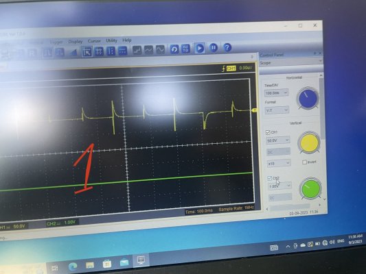

Here is what the IDM is sending to the easiest to access injector. This is with the injector unplugged.

How much voltage is that?
My understanding is the IDM feeds 100-130vac (depending on the revision).

On an 03 I believe the voltage sent from the idm to the injectors should be 120v.
If I remember correctly
obs is 100v
Early 99 is 110v
99-03 is 120v
Any of those idms can be swapped around the voltage doesn't make any noticeable difference.

Ah! Interesting! I set the range for 50v in that shot. I’m still getting used to my scope, so I’m not sure if it’s showing -50 to 50 or -25 to 25. I assumed -25 to 25, thinking those would be 12v pulses. I did wonder why the pulse went up and down—AC would explain it! At any rate, what you’re seeing is definitely not 100+ volts. Suspect bad IDM?

It’s also not much of a consistent pulse, is it?
By the way, I did test fuel pressure at one of the bowl plugs today. 64 psi dropping to 60 psi while cranking. Someone suggested pulling the fuel line to the rail and checking for pressure at the rail. Think that’s worth doing?

I’m also reading that the IDM kicks the voltage up to 100+ DC volts. That would make sense too, but in that case I’m not sure what’s up with my up-down pulse.
I will try to get a good picture of what is going on with those injector pulses. Maybe I can get a good capture and zero in on them. I’m inclined to think this is a pretty good picture of what’s going on. I think it might be time to talk to my friend about borrowing his IDM!

I just hooked my scope up to a 12v battery. Pulses are the same height, approximately, as those in the screenshot I posted, with the same range settings. So the injectors are only getting 12v maximum from the IDM. Looks like we found our problem. Will swap with the other IDM ASAP and report back.

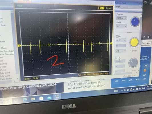

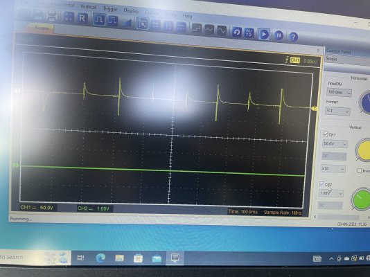

No change with the good IDM. I believe I misinterpreted the voltage my scope was showing earlier. Good IDM showed a similar wave form. Captures from IDMs 1 and 2 are attached. One vertical square is equal to 50v. These readings are taken at the injector connector. Do these pulses look adequate to fire the injector? I still do not see oil coming from the injector, even though I have verified ICP to be sufficient with a mechanical gauge. Is it possible the PCM is sending a weak signal to the IDM, and the injectors are not getting enough voltage for that reason?
