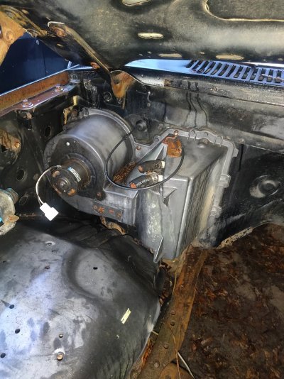

The hi output heater core is an exception to that, they are in the engine compartment regardless of A/C or no A/C. I worked on an 85 that had no A/C and the heater core was in the engine compartment
All 86-dwn non-A/C heater cores are under the hood, high output or not.
3,307
3,758
So on the non a/c system did they move the heater core to the a/c evaporator location?
I figured that the entire passenger side of the engine bay would be pretty much empty.
James

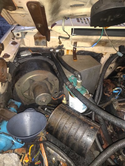

Here's a picture of my 84 bronco non-AC and how it is in a factory sence. And on my dually, I butchered up the AC box to make room and a place for a coolant filter.

I would have never guessed that it was designed that way. Since I don't have an engineering degree, I had just figured they did it logically and left the heater core under the dash.

When I "engineered" mine, I left it under the dash.
And really if you think about it, since it doesn't have ac, this leaves the heat under the hood instead of in the cab.

I guess that is true, but to me I would have thought it would have been much cheaper from a production standpoint to just redesign the blower housing instead of everything under the dash.

Like I said, they finally did figure it out in the 87-up trucks and left it behind the glove box inside the cab whether you had A/C or not. If you have a 1986-dwn truck, and have a butchered up old A/C box, a slick way to fix it would be to find a 87-up non-A/C truck and get the cover on the firewall out of it, and use that to replace the butchered up A/C box area. A non-A/C truck can be hard to find though as you get into the later years.

That's my observation. So I butchered mine up, I'll never fix the AC in my personal vehicle and I wanted space.
