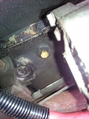

Anyone know where the bolts on the block are to drain the coolant. I started to loosen what i thought was it but it looked like oil was seeping out so i tightened it back down.

One is located next to the oil filter. Other is next to the starter. Mine were brass. After I drained the old coolant I added Teflon tape to the threads and refilled with Final Charge. They were also in the same spot on my Dad's 6.9 when I did his coolant change.

You're lucky that you had brass...the early blocks had a different style plug that I'm not sure was meant to be removable...or, at the very least, hadn't been removed in a long time. It took an act of Congress to get mine out :shocked: I replaced the plugs with pet-*****, and I'd recommend doing the same...this makes coolant drains MUCH easier ;Sweet Just get a hose on the nipple, loosen the pet-****, and drain the coolant into a bucket...if the bucket's clean and the coolant's in good shape, you can even reuse the coolant.
