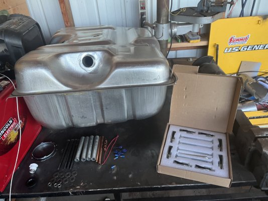

Is there specific tank straps or just use all thread to extend the originals?

If you want, good time to do the Vent Mod for fast filling. Don`t use heater Hose (I did, what I had) Go to your local hyd Hose shop and get a fuel rated hose. I used 3/4", I would go with 5/8". Not a lot of space between bed/tank.
My bed was metal to metal with no rubber bushing. Cut some rubber pieces which should have been there, and helped raise the bed a bit.
Don`t be surprised if the long bolts and pipe spacers are too short.
Swap the Nuts for Ny-Loc nuts.
To lengthen the pick up tube, use a compression fitting with one of the copper tubes.
I may have mentioned this before, hey Iam getting old. Have fun with your project.
