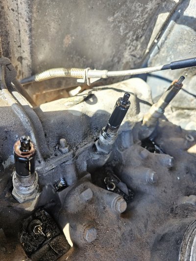

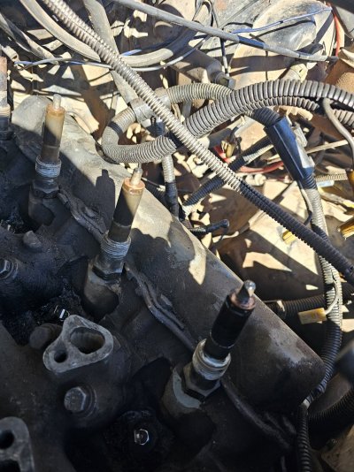

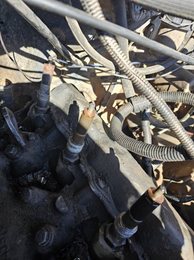

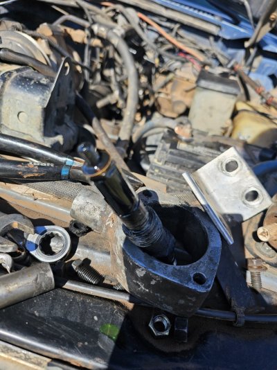

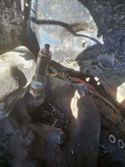

Found this when pulling injecors.
Azidiguy
Sep 22, 2022
121
51
Arizona
I decided to swap my injectors and turbo kit with another truck as well as the sidewinder turbo to upgrade my first gen ats.
I found several wet tips 4 were dry n mildly sooty like normal the one i was concerned wiith is covered in oil ( see pic). Ideas on cause i know the injectors dont have oil like a psd does.
It runs pretty good just was smokey n i had a feeling a couple were leaky as its been eating glowplugs
Thanks yall

Sorry. I got your current turbo set up wrong. Either way, it will be a good step up. Are you certain that it's oil and not a lot of soot mixed with diesel fuel? From what I could see, I couldn't see any oil in your pictures. What was on the injectors looks pretty clear and not black like oil would be.

that makes sense. It didnt really smell like diesel but the copper paet didny look too good when removed. I had about condemed the pump before finding those betting pump.is good to go. Thanks for the help hope it quits eating glow plugs now
