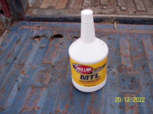

11,153
And are they a synthenic blend?
Nope. MTL is a full synthetic. You may have to zoom in to see it on the label. It's to the right of Red Line and above the "TL". I believe that Royal Purple is a full synthetic too, but I'm not sure on that.
