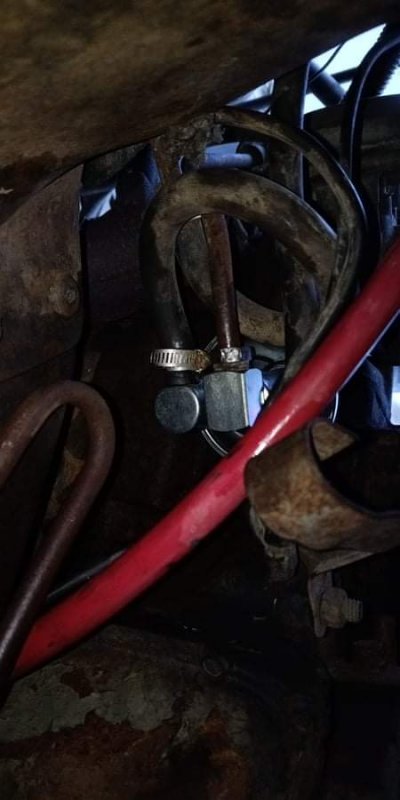

Another update. Decided to swap out the fuel pump as I noticed the pressure from the fuel filter schrader wasn't shooting fuel across the engine bay, was only coming out a little. Swapped that out and truck runs a whole lot better but she does continue to advance timing. I unplugged the timing advance on the engine and she no longer advances, but while going down hill above 65ish, I take my foot of the pedal and after a moment she starts to surge a bit. Possibly looking into a refurb IP soon I'm guessing?

It shouldn't "shoot" across the engine bay from the valve, at least in my experience. It should spray out a little as a steady stream but nothing extreme, as you'd expect for 3-6psi. I have an electric pump and even that doesn't shoot out very far without the engine running.
Im exaggerating a bit. But there is a significant notice in pressure.
