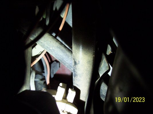

It may not help much, but this is the one on my 1985. It's underneath and to the driver's side of the blower fan in the engine compartment. It's the best picture that I could get at night. There's a plug and a red "plate" That's how they look on Bull Nose trucks.

Thanks for the photo but I can’t make out what is what..I’ll try to look for a schematic..

19A706 is the resistor. This is the picture if you have factory A/C.
