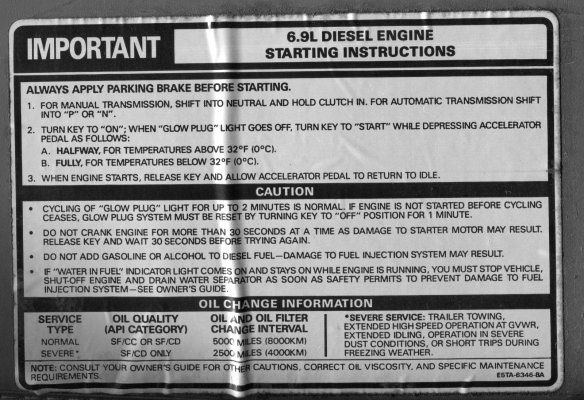

First, when I’m cold starting the truck, how long should I let it try to turn over, before I stop and try again? What is the correct timing of the intervals, my book says 15 seconds which seems long. Also, in my original owners manual, it says I’m to depress the gas pedal half way... is this true? I haven’t been doing this. Just the clutch obviously. I have not let it try more than 5 seconds before I stop. Then when I try again it fires right up, but I have a large cloud of white smoke, then a smaller puff of black. Is this normal?

I believe the throttle halfway is for normal starting. I think under 32F you're supposed to fully depress the pedal.

Cranking 15 seconds isn't bad, just let the starter cool off for a full 2 mins between tries.
Also you can try a double glow plug cycle-- if it starts right away you have 1 or 2 burned out GP's. Just cycle the keys after the first glow cycle to start another one right away. It'll be shorter since they are hot already but helps to start.

Often members suggest 10sec starting intervals to help preserve the starter.
White smoke is unburned fuel.
1) Could be 30-60 secs of turning over.
2) Could be a couple of tired or cold cylinders getting up to temp before firing right.
3) You should check the glow plug continuity. Open result means they are bad. Once 2-3 fail the system will turn on and off 1 second later.
1) I turn the key to on, it starts the glow plugs warming.
2) While the glow plugs warm up I press the gas pedal half down and let go. That sets the cold high idle. (Providing yours is working.). Now the truck will idle say 100rpms faster. I only get down to the 40’s around here and have not had to keep my foot on the gas.
3) I start the truck, it should really clatter at first and the quiet down. If not likely you IP is not timed correctly or cold advance is not working.
