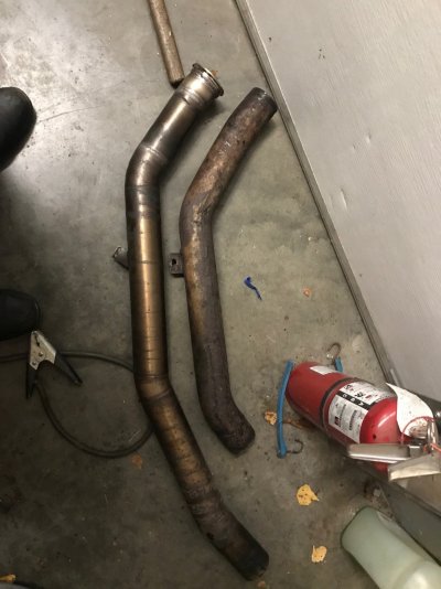

I bought a used ATS 093 turbocharger kit on fleabay a while ago and have been slowly accumulating parts and making repairs to get it ready. Then the home made oil feed line for my current 088 setup cracked for a second time last weekend and put my truck out of commission. I could have simply put a new oil line on, but since I was never too happy with the 088 performance, and there were other problems with it from previous mods, I decided it was time to replace the whole system.
Shoutout to @typ4 for supplying the fuel return kit and turbocharger seal kit. I also had to order several other parts from various places for the new oil line and exhaust components. I debated putting the water cooled center section from my 088 setup into the 093 but decided against it until I do some more homework on how it should normally be set up. Previously, I just had it plumbed in series with the heater core and it wasn't the most robust setup. Since I'm taking longer offroad trips lately, reliability is my biggest concern. Limping home with a massive oil or coolant leak is not fun. I don't recommend it.

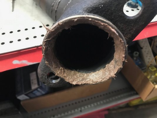

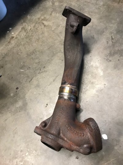

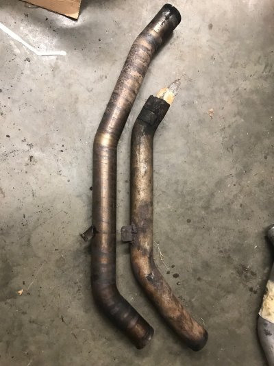

The used 093 Fleabay kit came with almost everything, including the downpipe and crossover pipe. They are pretty much toast however, since both are badly rusted and have already been patched by someone a very long time ago. Yes, they are repairable, but since I have stainless steel pipes that I made for my 088, it made more sense to use those. The old pipes are however a useful template to modify my existing stainless steel pipes.

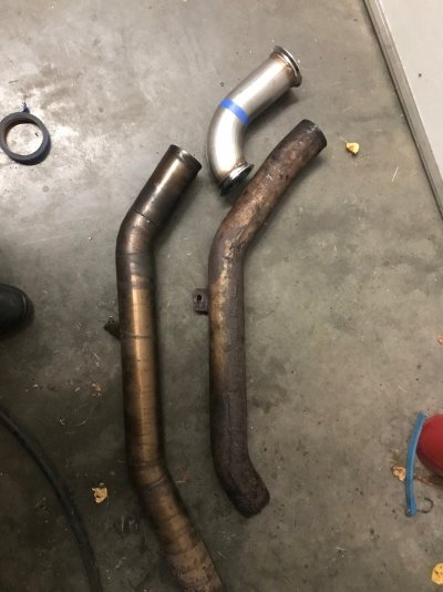

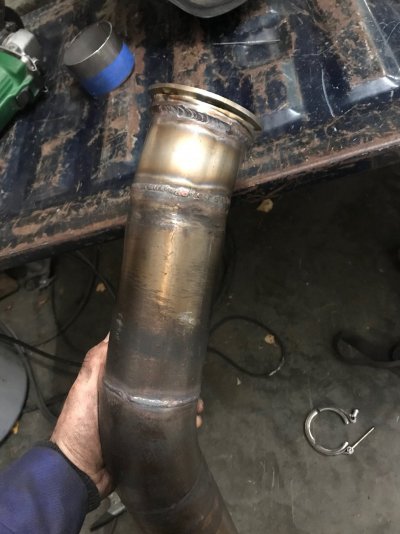

The first major modification was for the downpipe. Although similar, they are NOT interchangeable between the 093 and 088. The 093 is a good 4 inches longer, and that extra length is bent slightly to the side. It's very subtle but the bend is required for the best possible clearance at the firewall/floor seam. I bought a short length of mandrel bent stainless pipe from Amazon to make up this difference. Although the bend is so slight, that anyone could simply notch and weld to get the same result (you won't notice a performance drop from such a mild corner). I also had to adjust the bend at the firewall corner slightly, but I don't know if a factory 088 downpipe would have had the same problem. The one I made often hit the firewall when reversing up a steep hill, so it may have been a build flaw from my end.
The other modification to the pipe was to add a V-Band Clamp to connect at the turbocharger. This is not strictly necessary since the slip coupling still works fine, but I just the idea of something that seals better than the slip coupling, while also being easier to remove. To weld the cast iron turbocharger outlet, I used 316L stainless rod in two passes. Then I heated up the welded area and let in cool for an hour inside some fire blanket. No cracks are visible so hopefully that's good to go. This is the same method I used for the Y-pipe slip coupling repair.
And then since all the header wrap got soaked in oil, it all had to be replaced with fresh wrap. Hoping to finish the install this weekend so stay tuned for more updates.

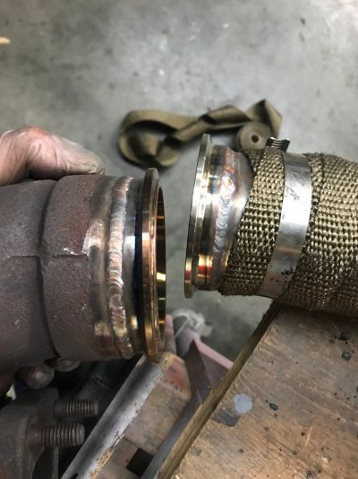

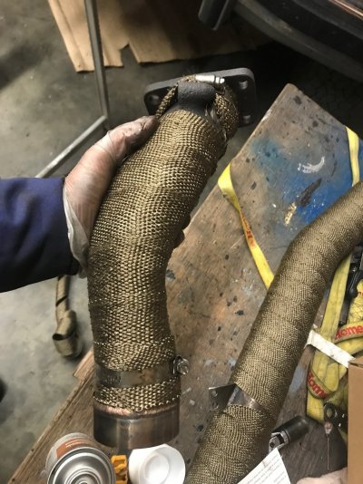

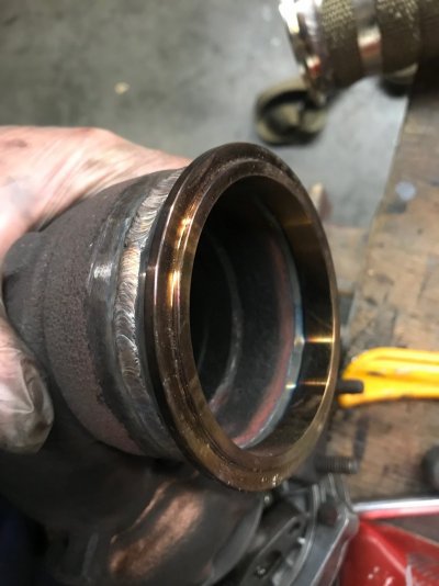

Here are the welds for the V-band clamp. There is a surprising amount of room at the firewall for this and I don't anticipate any interference there. I'll admit these aren't the prettiest welds I've done, but they will hold just fine.

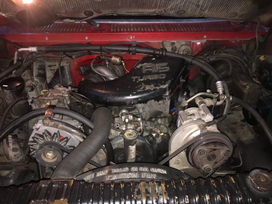

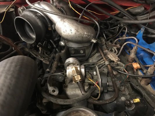

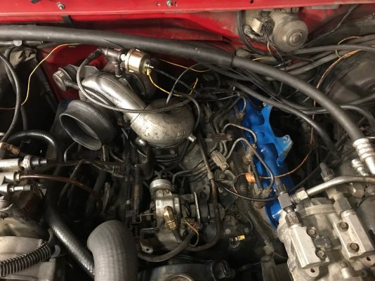

More progress..

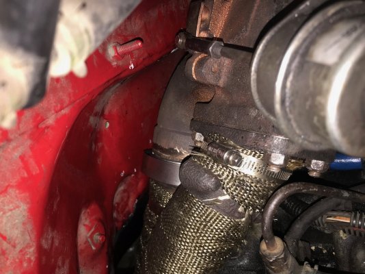

The turbocharger is now permanently installed with all new seals.

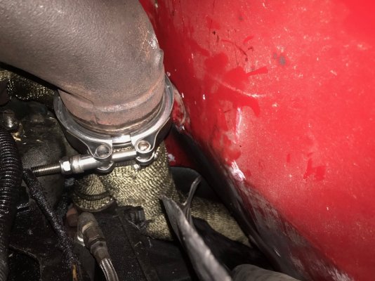

The crossover pipe had to be tweaked narrower by 0.25" to match the new Y-pipe. No biggie. I also used that deacon muck that @ocnorb tried to use recently on the slip coupling. The heavy wall stainless steel that I used to build this crossover pipe is so rigid that it doesn't like to conform to the manifold taper. I'm hoping this will help seal it but no big loss if it doesn't.
You can also see clearance to the firewall with the V-band clamp. Looks to be over half an inch so not bad. Still a mess under the hood with lots of organizing still to do. Looks like I will also have to build a heat shield around the turbine side.

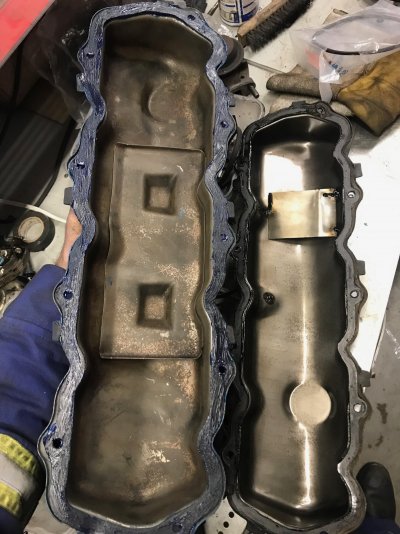

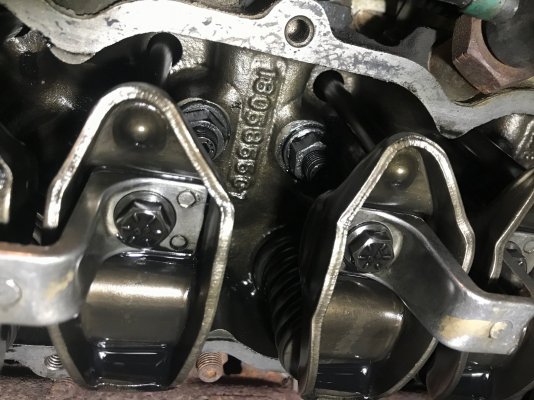

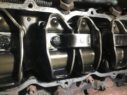

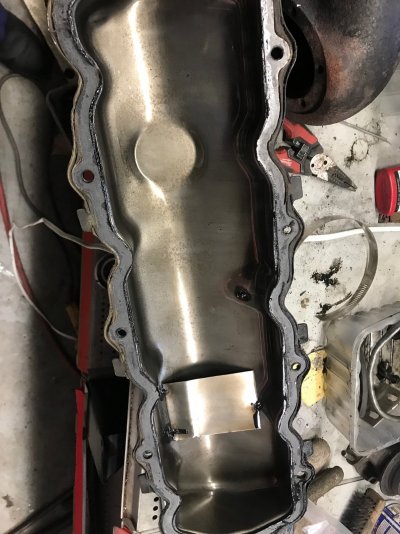

The kit was in pretty rough shape but was about 90% complete, including the driver's side valve cover. I cleaned it up shot a coat of blue paint on it. A bit of good news is the appearance of the engine internals when I opened it up. Not hint of sludge, so it looks like I'm doing an okay job with maintenance. You can see the comparison between the old valve cover and the new one on the inside.

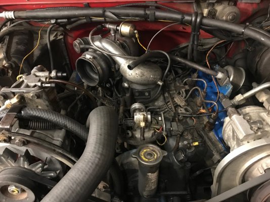

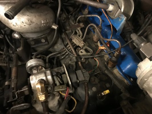

So far so good. Builds boost to 7 PSI rather easily, then hits a wall when the wastegate opens. Very happy with the early results. Photos here show some minor mods that were necessary to get the airbox to fit. The steel return line had to be messaged to fit as close to the intake manifold as possible. And the front driver's side fuel injector line had to be bent to follow a relief under the airbox.
I tried to install a stewart warner oil pressure sending unit but the gauge wouldn't respond so I had to revert back to the ford sensor. My plan is to modify the gauge to read dynamically, rather than [on = middle] and [off = zero] that it has right now. Have to do some more homework on that mod.
Engine noise seems a bit higher at idle for some reason. I can really hear the mechanical noises of the engine much more. Outside sounds no different, so I doubt it's due to any internal engine damage. What's also interesting is that the new valve cover is one layer of steel, while the old one is made of two layers. Not sure if this is the reason for the extra noise but I can see a future mod may include some additional firewall insulation. I may also decide to strip the whole airbox one day and leave it raw aluminum. The peeled paint looks like crap but it probably won't affect power output (maybe I'll compensate with some stickers...)

The V-band mod was easier than I thought it would be, and like I mentioned earlier there is plenty of extra room around it even without a lift. I didn't even cut anything off the casting so if the weld fails for some reason, I can still revert to the slip coupling setup. I always try to play it safe with mods that can be rolled back if it doesn't work out.
