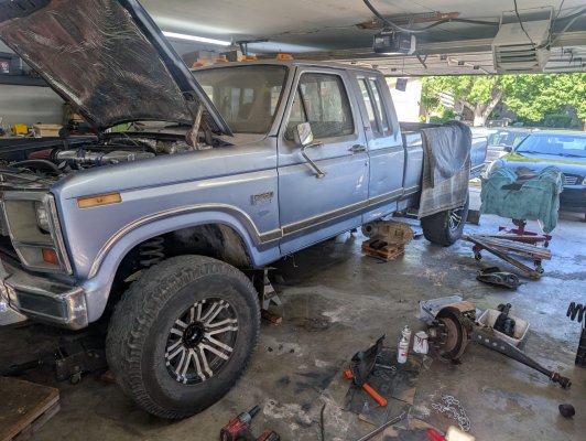

Finally found a 3.73 ratio SRW 2906 Dana 60 axle for less than a grand (I know they are cheaper elsewhere, I'm the great state of California).
Stalled on the intercooler reservoir, the tank leaked from a few spots, either my welding skills aren't awesome or using a random propane bottle from a 70s VW camper van wasn't the best idea. Or both.
Anyways, will start work on the front axle swap soon while keeping an eye out for a ZF5 4x4 mid ratio trans. Have the close ratio already but seems like gear ratios might be better on the S5-47.
