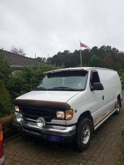

I have previously owned two 7.3 idi - E350 , and one 7.3 turbostroke. Now I am at my second E350-7.3 turbostroke. A 2001 model car......
The question here is about a friends 1992 7.3 idi.
He wants to put in a newer engine, from a 1996 7.3 turbostroke, but is a little worried about how much work it will take..... Is there any treads here that do explain this swap?
