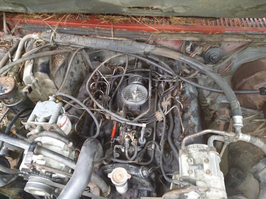

Can you post a top down pic of your engine?
Like this viewpoint:

Are any of your return caps leaking?
After you had the system "open" by changing the line, did you bleed the air off?
You can temp replace the two return lines I circled with the clear line you already have to help troubleshooting and then bleed the system.
If you dont know how to bleed it let me know.

Did you replace the "olives" on all the hard lines?? Looks like they are leaking fuel. Also, get a new cowl gasket before you get water in the engine thru the intake (even with the filter assy installed). I placed an old rubber mat over mine since it leaked again with a new gasket after heavy rain, parked on a slight hill & bent 2 rods from Hydrolock. Early 80 years are bad about it.
