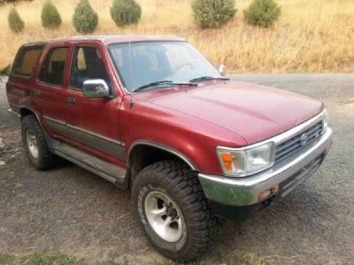

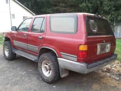

I have a 4runner and a 6.9 idi I want to build this idi to push 400-500ft lbs of TORQUE not HP I'm looking to eventually twin turbo the 6.9 In the near future so keep that in mind. I'm looking for injectors want to spend no more then 550$ on injectors, 850$ on a injector pump, I want cams but can't find any, want pistons but find very few 575$ max I want to keep beginning project under 3k$ 4runner and engine, transmission, transfer case cost 900$ so with the prices set should come out barely over 3k I can adjust a little if 100% sure it's worth the extra $$$. Now I know 3k will not get me where I want but should put me close. I'm dead set on the 6.9. I will not even take consideration for any comments to switch I have already done bought both its a done deal.
All I'm asking for is finding these parts or follow my build
please don't leave comments about how hard it will be or how much fab it will take im very aware of what im getting into its just been a dream of mine.
