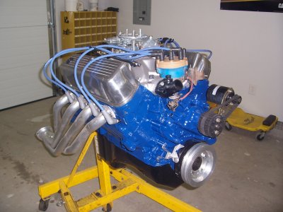

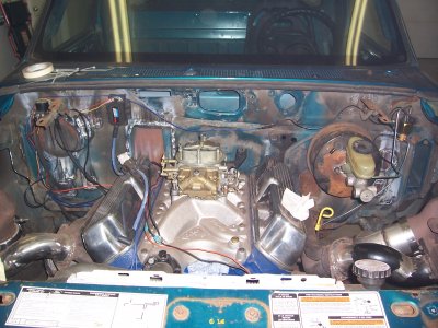

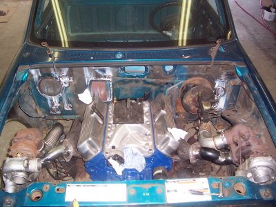

I built a twin turbo 357W for my 94 Ranger for drag racing. I'm using two 6.5L GM diesel turbo's....Here's what's in my engine:
351W bored .030" over (357-CID)
re-conditioned stock "football" rods with ARP Waveloc HP bolts
Speed-Pro .030" forged pistons, 8.56:1 compression ratio
Home ported E5 351W heads
ARP head bolts
stock 1.78/1.45 valves with Comp Cam springs 10 degree locks/retainers
Erson anti-pump up lifters
Erson hardened pushrods
Weiand Stealth high rise dual plane intake
Holley 750cfm double pumper (boost prepped)
Stock Duraspark-II dizzy, Accel cap/rotor kit
Crane HI-6S ignition
Holley lasershot pro-strip coil
Comp Cams 280H grind flat tappet camshaft (.512" lift, 230 duration) (not used with the turbo's)
Longtube headers, 3" collectors and 1-5/8" primaries
85 Crown-Vic double hump oil pan
9mm FRPP plug wires
Edelbrock dual idler gear drive timing set

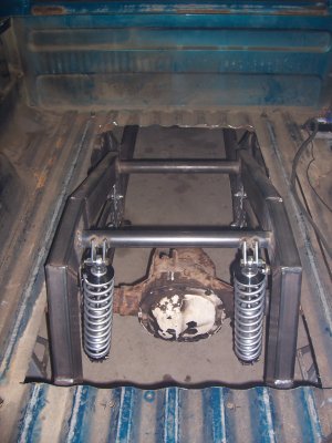

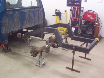

I'm in the middle of mounting my fuel system now, it consists of an Aeromotive A1000 pump and A2000 regulator with 8AN and 10AN fuel lines. The rear chassis was toast so I fabbed a new one with a Comp Eng 4 link and QA1 coilovers. Hope to make 500+HP on pump gas with an air/water intercooler and 15psi of boost.
