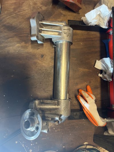

I’m Starting on reassembly now with the new oil cooler bundle.
Decided to go with the siliconed felpros for this reassembly since a similar material (different brand) sealed up nicely to the block.

Looks like I need to press the end caps together just about 1/2” more

The big "O" Rings have to snap into their new home. You will know when they do, guess kind of like pushing on the Injector Return caps. They snap into place. Just takes more force to get these seated.
When I did mine, one end went right on. the other end seemed to take more force, then...Bang it seated.
Used my 20 ton Press. Used a little pressure, tapped around with a dead blow, lil more pressure etc...
You bought a new OC from Ford, right?
Not a Dorman?
I painted mine so it wouldn`t rust. It`s JD Yellow.

You caught me, it’s a dorman. Found it on Amazon for $250 and I figured my luck could be different.

The important part is that I got an oil cooler from the f350, and it looked good coming off. It could be promising
I got all 8 bolts threaded into my motor now. I got rained out for the night so I’ll pick it up tomorrow

Without reading all of this if you use the metal gaskets that's your problem they don't work. They had one job and could have made a stellar part and they screwed it up. That said I hope you didn't throw away your old cooler bundle that one's easily cleanable. I'm having custom thicker gaskets made for my oil cooler repair kits here's a link.
