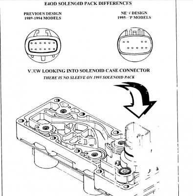

ok so if you sourced a used diesel e4 with a 6 stud converter,then it came behind a power stroke.the electrical connector for the solenoid pack is different,so what was done there to make it work?

As far as I know we can't run the E4OD from a psd engine that has the 6 bolt converter unless we change the solenoid pack. As posted the plug connections are different. Any chance you checked the tps on the throttle shaft of the injection pump? It MUST show at idle setting with key on but engine off a voltage of .96 to 1.2. This is a MUST have setting and these tps switches don't last forever. Figure about 70,000 miles and change them. They wear out.

I did not do any alterations to anything, the plug look the same when both were on the ground. only change was converter. if the solenoid pack is different, I did not see it, how it is sorta working I do not know? can I change out solenoid pack to hopefully correct?

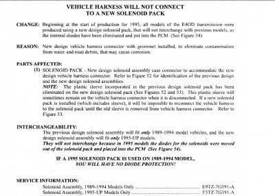

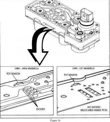

yes.you need to use your older solenoid pack.iv no clue how or why your plug on your truck was able to fit the newer style though.only you know what the story is there cus your not telling.:D

didn't see your last post until after I asked, going to check the plugs again. are they so different to where the harness wont slide on?

ok here,s the scoop. old trans has the proper plug set up. new trans has new style. the female plug on the harness is missing the snap clip that if on there would keep it from sliding in. so with that said, you can slide a broken plug into new solenoid pack. going to get new pack and hopefully a plug. will post results asap. thank you for your guidance

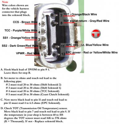

I hate to say it, but a loose plug on your old tranny would cause exactly what you described initially... I doubt it was mechanically bad (except for damage from starting in overdrive!)
If you check the codes it may help you trace down which wire(s) are intermittent. I'd also check continuity from the solenoid pack plug up to the TCU (TECA?) while wiggling the wiring around. I'd guess a broken wire or jacked up connector somewhere along the line

installed new solenoid pack today, did change things but....... still not working right. put in drive and takes off in 2nd and will not up shift unless I put gear selector in 2nd then back to drive, then goes into over drive. sorta like before but not locking up converter now. come to a stop, then take off, same thing. it will go into 1st if I put shifter in 1st gear. and od light turns on and off now, where before it stayed on so it did change. going to start chasing wires. any where to find wiring diagrams???
