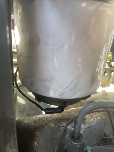

really just looking for troubleshooting advice of where to go from here. I have heard there is something in the IP to check? Also considering deleting the bowl on the fuel water separator, but am concerned about the wire running from it giving me a dummy light.
I have found trace amounts of diesel there when running, tightened the life out of it, but I have a new bowl on the way.

Update: I have replaced one fuel cap that looked like fuel was getting around, and the bowl to the fuel water separator with a plastic see through one.
The truck is still doing the exact same thing.

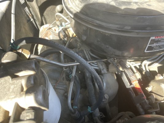

I found this guy, runs from the hardline coming from the tanks, to the hardline going to the mech fuel pump. It’s sucking air. My question is should I be installing a 1 way valve or check valve on this line?

You don’t necessarily need a check valve just before the mechanical lift pump, as there are check valves in it. Just repair the leaking hose and run it like that.
Agreed. If you're seeing less fuel in the fuel filter, then air is probably being added to the fuel filter in place of the fuel. That being said, air is entering the system prior to the fuel filter. Likely the connection you have in the pic above. I don't believe you need a check valve. Just repair or replace this section of hose and see how the truck responds. Good luck!
