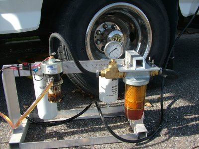

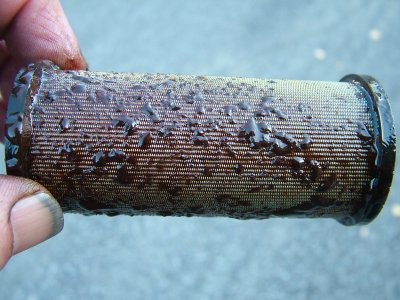

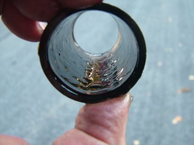

pump is not broken. just clogged up with algae slime:eek:
Clogged up with algae slime is putting it quite mildly. That stuff is a cross between gorilla snot and crazy glue. I haven't found anything which will cut it, clean the screen. If anyone has suggestions I'd really like to hear them.
I ran the filter unit for 3-4 hours, filtering both tanks on my truck. I cleaned the screen a couple times as best I could, but finally admitted defeat. That algae is some nasty stuff.

dude that looks like filter/strainers we use on our sonic cleaner tanks.... you might try measuring it and running down to a local industrial supply house and see what they might come up with. Yours looks to be a finer mesh than ours but I'm sure they can be purchased in varying degrees of filtration.
ken-
that's downright fugly.......
it's amazing how the pump was able to pull through that crud....:eek:
now that's stress testing;Sweet

Since it sounds like this filter is a little hard to come by, maybe it would be better to pull it through a golden rod with one of those sediment screens first, then through your pump, then through the regular golden rod or what ever filter set up you are using in the picture.
