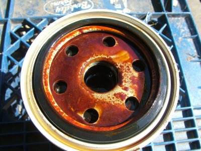

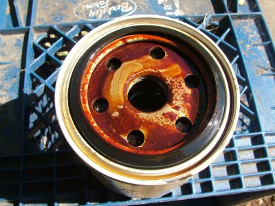

Thanks for the reply. You might be onto something there with your thoughts about a critter farm. It's a possibility, though I would think that would affect the engine's ability to hold at 2000 rpm. I've held it there for a full minute without skipping a beat. It does great until I let off the pedal. Then it's just like I turned the key off.
I've removed the fuel filter, and found some brownish-red sludge. The fuel filter doesn't have that many miles on it, but the fact remains the fuel is old. I'll post two pictures of the sludge.
Interesting aside: This is a WIX filter. The white paint on the outside of the filter is softening and coming off. It's like it's been hit with a good paint remover.
